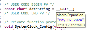

Gcc and Visual Studio correctly compile today's date __DATE__ to "May  6 2024". However STM32CubeIDE editor expands the macro incorrectly if I hover the cursor over it.
  • Month name is in Dutch
  • Month name is in lower case
  • Day of month is left-padded with 0 instead of a space

I use STM32CubeIDE 1.11.2 at the moment. My system language is Dutch. I can check if the same problem persists with a newer version.
You did manage to reproduce part of the issue. The day of the month should not be left-padded with a zero, but with a space. If you compile GCC uses the proper format. It's only the preview in the editor that is incorrect.

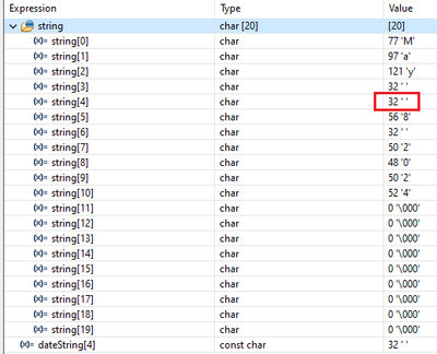

This is what I get with CubeIDE 1.15.1:
Day of month is left padded with a space.
Ok then it's only the display popup is different but the string contains the correct char: a space. Do you see an issue in that behavior?

Issues are only in macro expansion in editor (popup as you call it), not in binary.
I tested with a freshly generated project and an old project and in version 1.15.1 as well. Issue is not project specific.
In STM32CubeIDE 1.15.1 I get the same result as you. So only the left-padding issue, not the language or capitalization. And in 1.11.2 and 1.10.1 I see all three issues. So it seems the issue got half-fixed at some point.

I'm not seeing a blocking issue in that since it's only a display and doesn't impact the cross-compilation result meanwhile I'm raising the internal ticket 180951 to fix this minor issue. This ticket is not accessible by community members.
I will get back to you for any feedback: to fix or not to fix.

Problem with zero-padding still present in STM32CubeIDE V1.17.0.
Tested in windows sandbox to allow changing of system date (my work PC doesn't allow me to change system date).
