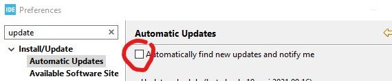

After upgrading to the new version of CubeIDE (Version: 1.6.1), the change between two .ioc configuration cards takes about two minutes. Could you please speed it up?

Same problem here. After upgrading it takes two-three minutes. Where the problem is ?

Could get a try to perform a fresh install STM32CubeIDE - Integrated Development Environment for STM32 - STMicroelectronics to get a try with.
Please share if still facing performance issue based on ?
If yes :( could you create Thanks such 1.6.1 release a brand new workspace and just import your project in relying on File > Open Project From File System. Any progress ?
If performance issue IDE session please could you share "Help > About > Installation Details > Configuration" tab content ?
FVese.1
Good day,
I'm sorry, but I'm currently working on an important project, so now I can't reinstall the development environment. I would have to reset everything. The configuration log contains a lot of personal information and folders and projects, so I can't share it publicly. If you need anything specific from it, I can find out. I think thanks to the update I have the latest version and the problem with speed persists.
Ok sounds fair. Could you just have a try disabling auto updates and comment if helpful or not ?
