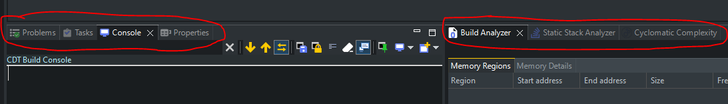

How do I change font size in following views ?
I searched in 'Window>Preferences>Appearance>Colors and Fonts' but could not figure out which entry to edit.
Edit: I mean changing font size of the content of the views

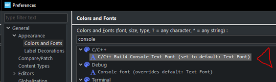

I found the entry for 'Console', few more to go

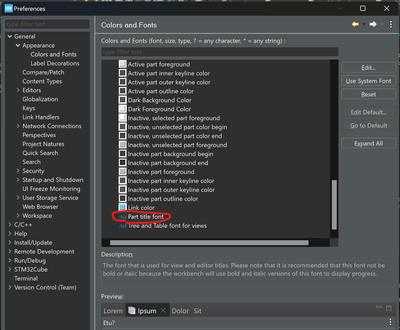

The "Part title font" setting will change the font used for the title of tabs.
Thank you @TDK , I planned to ask about that in another post. Sorted.
