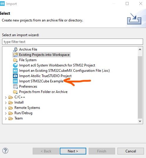

I've imported a SW4STM example into CubeIDE, it worked fine.
Then I import this already converted project into another CubeIDE workspace and this fails.
The project becomes "orphaned", no toolchain defined.
It looks like CubeIDE creates duplicate Debug config. After import there's two configurations named Debug.
I deleted one and the 'orphaned' error disappeared. But the project still does not build, something is broken. :(
CubeIDE version 1.5.1 on Ubuntu, target MCU is STM32H743

Just so I get a clear understanding of the issue:
- You import an SW4STM32 example into an older version of CubeIDE to then import to a newer one? Or from 1.5.1 to another workspace still being 1.5.1?
- How do you import the project from one CubeIDE to the other? (Or the other workspace with the same version if that's the case)
- Which example did you use? I have access to a Ubuntu machine so I could try to reproduce the problem.

‎2021-02-18 12:17 PM
Hi Markus,
The 2nd time I don't select "copy project into workspace".
I'd like it to stay in the original place with all its dependencies.
The problem is not that it won't build successfully after 2nd import, but that it even loses some basic features (natures or whatever)
-- pa
‎2021-02-19 12:21 AM
"copy project into workspace" is not supported at all because STM32Cube examples are heavily relying on symbolic link like Eclipse feature. Doing local copy is killer here because Eclipse does not manage link remapping properly then.
According to me such is part of documentation : https://www.st.com/resource/en/user_manual/dm00613836-migration-guide-from-system-workbench-to-stm32cubeide-stmicroelectronics.pdf
If expecting to copy locally example material, if hopefully part of supported ones, please rely on dedicated import example feature which is promoted as part of STM32CubeIDE
