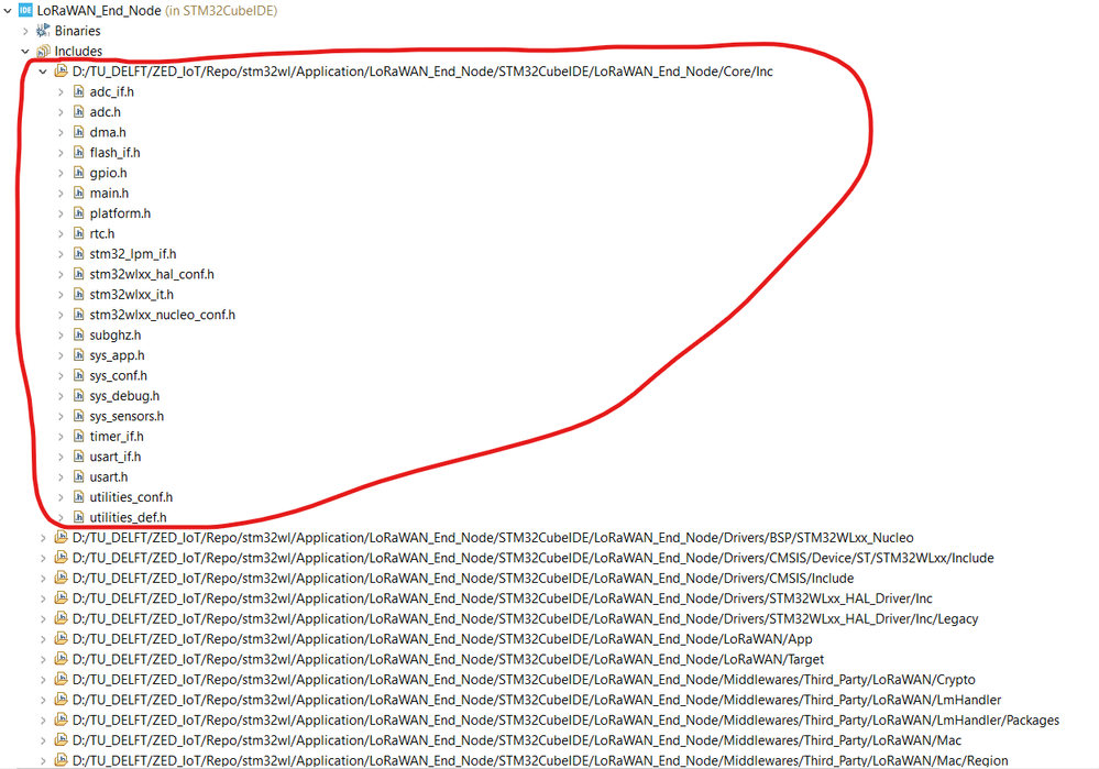

Sorry to bring this thread up again. If I want to add new header file to one of the Include paths, how can I update that path to display the new added header files?
Right now, I added new header files in Core/Inc (not shown in Project Explorer) but when I expand Core/Inc, the new added header files are not there.
Should be a refresh option. F5 or right click refresh or something.
Hello, thank you for your response. I did that already but nothing was updated. This was one of the thing I did: Via File Explorer at the Core/Inc, I created a file called testing.h. Then, although I refreshed the Project Explorer tab many times, there was no testing.h in the red area.
The screenshot you posted is not a file listing of a directory, it is a list of files included in the project, hence the “Included�? node above them. The file listing is farther down the screen.
This feels like a different issue than the OP.
I am sorry. I looked at a wrong direction. That is why I could not find my newly created files. Thank you very much for your response.

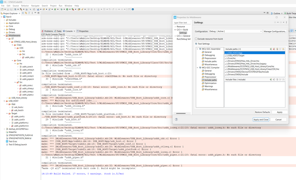

Hi, I'm having a similar problem. When compiling, I have errors saying that header files do not exist. The project is a simple PWM on a LED. The include paths are configured. I cleaned the project, workspace, etc and restarted everything but the errors are still there. Any idea on how to solve this problem?
Example:
.../Middlewares/ST/STM32_USB_Host_Library/Core/Src/usbh_core.c:22:10: fatal error: usbh_core.h: No such file or directory
   22 | #include "usbh_core.h"
usbh_core.h is in /Middlewares/ST/STM32_USB_Host_Library/Core/Inc which is a configured path (see screenshot)
P-S: F3 does work so the IDE recognises the files.
