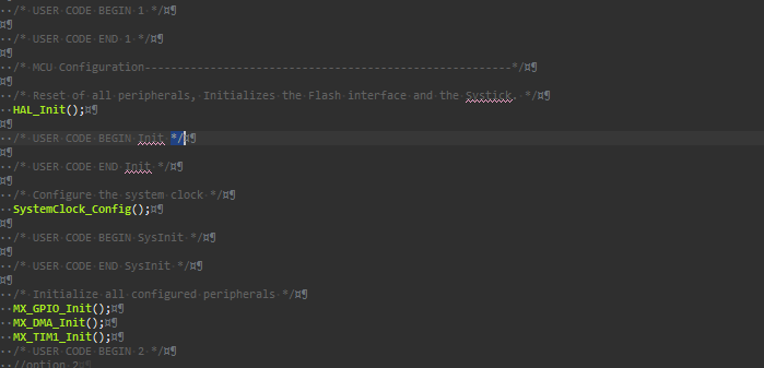

CUBE IDE shows some strange character

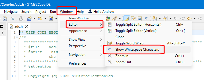

The icon that @Radosław showed is a toggle button in the toolbar. Click it to toggle whitespace.
‎2024-09-04 7:17 AM
You can configure it in Window>Preferences>Editors>Text Editors then click on the link configure visibility. And select/deselected what you want your IDE to show or not.
‎2024-09-04 7:21 AM - edited ‎2024-09-04 7:43 AM
@thannara123 and if you can't see it on a toolbar, it's under the 'Window' menu:
As the name suggests, it's showing you all the whitespace characters - CR, LF, Space, and TAB.
Note that this is a standard Eclipse feature - not specific to CubeIDE - and common to most IDEs and Programmer's Editors.
https://mcuoneclipse.com/2012/09/30/white-space-or-not-thats-the-question/
