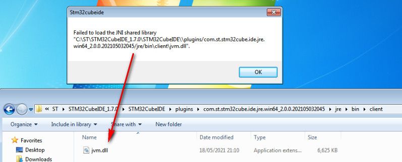

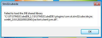

This issue is all over the internet, and as usual with no good solutions.

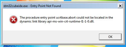

One of the two files which Cube says is not present actually is in that directory. I am totally stuck, having spent a day on this and downloading all sorts of VC++ redistributable fixes. I am doing this on two machines, both running a win7-64 VMWARE VM. This is Cube 1.7 although I tried 1.6.1 also (which I have running ok on the base machine, but that machine has had years of updates...
Of course google searches take one to needing C++ redist update 2015 but that generates error 0x80240017 :)

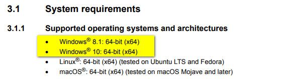

A little update: v1.4 installs OK.
So for win7-64 this looks like the only option. One can then update Cube using its own update feature, which currently offers 1.7 as the only option. However that fails too and you end up with the above error messages.
Edit: just discovered the likely cause of the problem: ST changed their system requirements post v1.4:
 although for some reason the online update to 1.6.1 worked ok on two win7-64 machines. But doesn't work on a 3rd win7-64 Enterprise SP1 running in a VMWARE VM.

Cube 1.4 and 1.5 install and work. 1.6 does not.

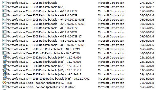

It appears to be a dependency on which version of VC++ redists you have installed. Cube seems to need at least VC++ 2015, but this is extremely difficult to "just install"; you get obscure 8 digit hex error codes which google to huge numbers of ineffective solutions. The way to get VC++, up to 2019, was via regular M$ Windows updates, but they stopped a while ago.

"VC 2017 should work on Win7."
It does (this is from my win7-64 PC). You just can't install it from any of the install packs. It used to come on the M$ auto updates but they stopped (except for paying M$ support customers)
and sure enough Cube 1.6.1 runs fine on this PC. I just don't dare try to update to 1.7 in case it is broken on win7, and then I could get stuck.

Cube 1.7.0 works fine under win7-64 SP1. Same compiler version as 1.6.1, too! More detail:
