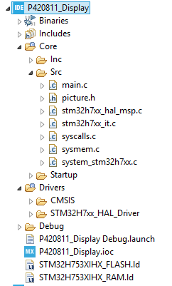

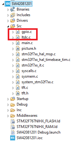

I have noticed , that when I generate a code, the the file structure looks different for both of them even when I try to ise exactly the same drivers.
For example when I use GPIO and LTDC, the for the STM32F767 I get such a structure (looks better for me):
And when I generate the code for the STMH753 then I get such a structure and the initialization functions are directly in the main (not optimal for bigger projects):
My question: How to change the automatic code generator to use the same way of working like for the STM32F767 (modular code)?

‎2020-05-09 2:09 PM
In STM32CubeMX, go to Project Manager -> Code Generator -> Generate peripheral initialization as a pair of '.c/.h' files per peripheral
‎2020-05-09 2:09 PM
‎2020-05-09 2:27 PM
Thank you! That was what I was looking for :)
