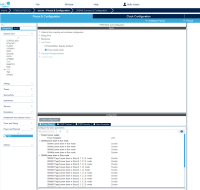

Cube gives warning to enable non-existent setting on U575 project
Eqqman
When compiling code for the U575 from the IOC file a warning pops up that SMPS must be enabled.  However, we cannot find this setting under the PWR tab nor via the A-Z listing of properties.  What must be done to clear this warning?

Hello @Eqqman
Can you add more details (which MCU are you using exactly and which CubeMX version).
Best Regards.
STTwo-32
STM32CubeIDE
Version: 1.15.0
Build: 20695_20240315_1429 (UTC)
Also happened with the previous version of the software. Chip selected is STM32U575ZITxQ.
