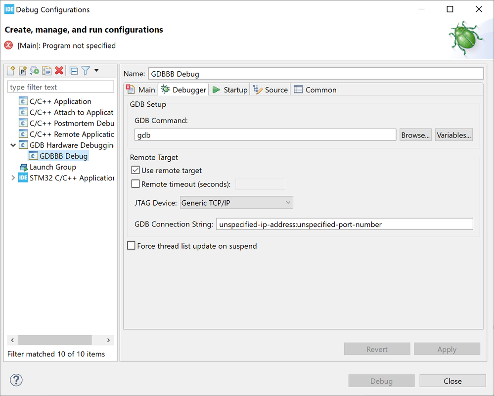

I am trying to debug a program in STM32CubeIDE on a Renode emulator, with a running gdbserver, started by Renode.
So in Debug Configurations dialog, Debugger tab, there is a radiobutton Connect to remote GDB server, but when clicking Debug, it complains about no ST-link being found.
Is it possible somehow to set things up such that I'm debugging only with GDB, without requiring a hardware debugger?

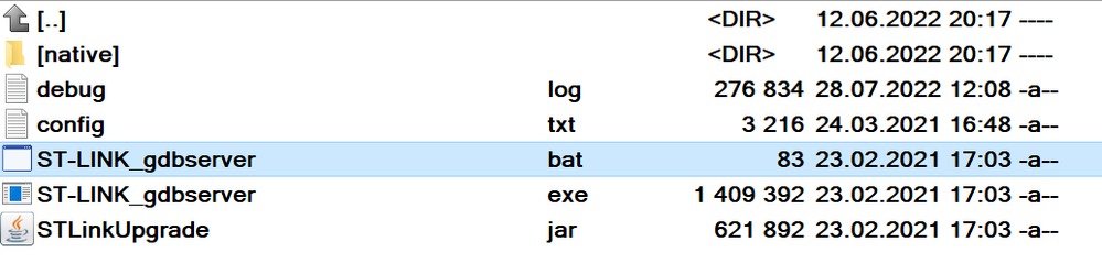

Is the ST-LINK_gdbserver _the_ thing that requires the HW debugger? Because, I set in the debug config to connect to a "remote server", which souns to me like it would not do anything with the ST-LINK_gdbserver.
MM..1
November 3, 2022
This i use with stlink remotely. But i mean isnt for renode.

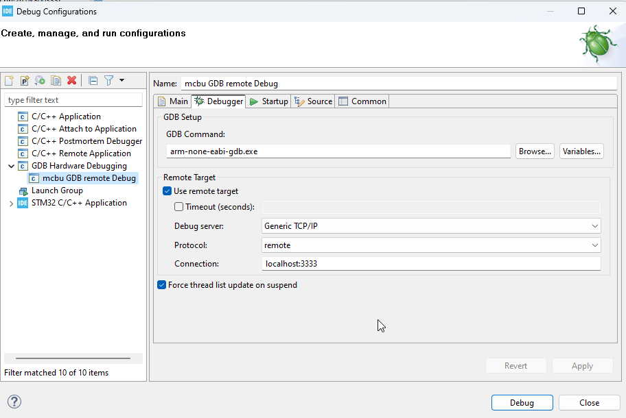

With the hints provided by other users here in this thread, I got remote debugging of an application running on an emulated STM32 MCU in renode working:
  1. Load your machine in the renode monitor shell. For example: (monitor) include @scripts/single-node/nucleo_l433rc_p.resc
  2. Start the GDB server in the machine to listen on port 3333 (or any other unused port): (nucleo_l433rc_p) machine StartGdbServer 3333
  3. In CubeIDE (v1.13.2) add a GDB Hardware Debug configuration like this:GDB-remote-Debug-Configurations.png
  4. Click the Debug button so that the debugger connects to the GDB server
  5. Start your machine in renode
  6. Use the debugger in the CubeIDE
