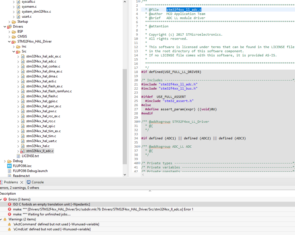

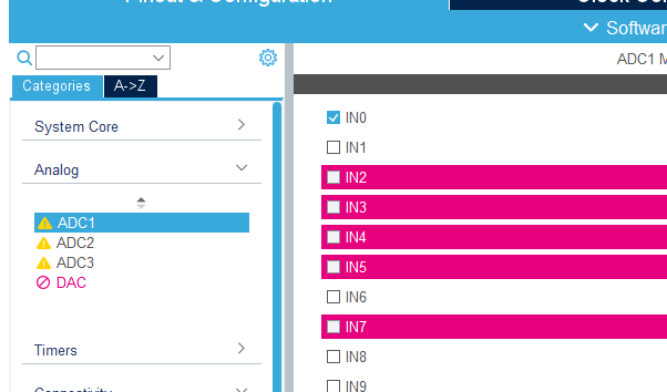

I configured ADC1 on IN0, see image below:
When compiling the project, file 'stm32f4xx_ll_adc.c' is 'empty' because all compiler directives are not fullfilled
1) what is file 'stm32f4xx_ll_adc.c' for?
2) is this behaviour a bug or a feature?
3) what to do?

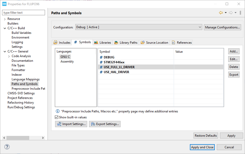

Define USE_FULL_LL_DRIVER

‎2023-05-29 10:41 PM - edited ‎2023-11-20 8:49 AM
Hi Rim
I used CubeIDE 1.12.0. When I manually add the LL-Driver compiling works. See the according entry in the properties below:But I do not understand why CubeIDE is not intelligent enough to recognize that a configured ADC needs this driver and set the according property automatically.
