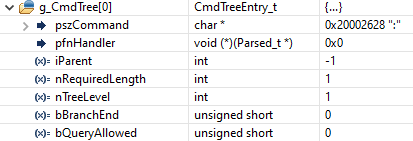

This is the memory address of pTreeEntry that is being placed in RAM but the address of pszCommand is not in RAM.

For some reason, the inverse gives me a warning. There is no warning when it compiles with the * in front but when I remove it I get this warning:
dboland
If I run it without the * in front of pTreeEntry the variable gets the correct value as well as a bunch of other repeating stuff.
However, the next time pTreeEntry->pszCommand is written to I get a hard fault again.

I have been using the debugger but without any success. I do not understand why it is pointing to ROM and not RAM, because the g_CmdTree has the pszCommand initialized in RAM but when pTreeEntry is set to the address of g_CmdTree[0] it is only seeing the ROM address.
