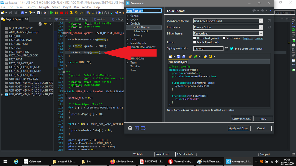

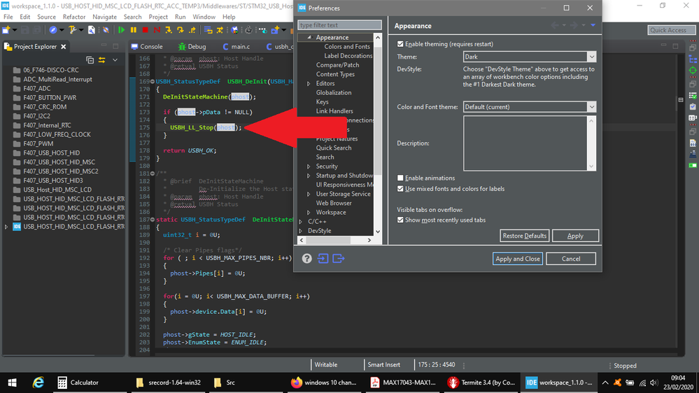

I would like to try the dark color theme in the IDE, but after activating the theme, some colors did not have a good contrast.
I tried to manually modify the colors.
And it was not possible to change the colors of most things.
I tried to modify all available checkboxes, but it didn't work.
I went back to the classic theme of colors, light colors and tried to modify the colors manually.
The colors could not be modified.
Does anyone know when this will be solved?

I tried Eclipse and even the latest version (2019-12) has this same problem.
But I managed to customize the color.
Just install an additional theme.
In the 'Help' menu, go to 'Eclipse Marketplace...'
Search for: 'Darkest Dark Theme with DevStyle'
STM32CubeIDE default dark theme:
Custom Theme:
Ref.:
https://www.genuitec.com/tech/darkest-dark/
https://marketplace.eclipse.org/marketplace-client-intro?mpc_install=27025

Nice find. Did you have to do something to get the scroll bars dark? Mine are the original gray but yours looks fine
February 25, 2020
Hi, What IDE version are you using? This IDE from the image in the post above is version 1.2.0, (I'm downloading the new IDE 666 MB, version 1.3.0, for testing), I couldn't find this defect in the scroll bar. I don't know if there is any influence, but Windows is also dark in theme. Could you post a screenshot, please?
