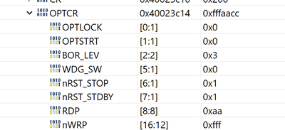

Show a screenshot of the contents of the FLASH_OPTCR register just prior to the line where you set HAL_FLASH_OPTCR_OPTSTRT.

Before executing the line where I set HAL_FLASH_OPTCR_OPTSTRT:

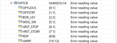

After Executing the line where I set HAL_FLASH_OPTCR_OPTSTRT:

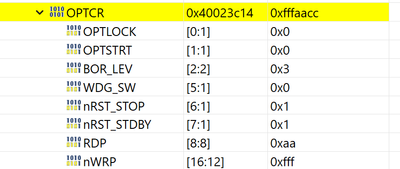

After Executing wait instruction for Busy flag to be cleared:

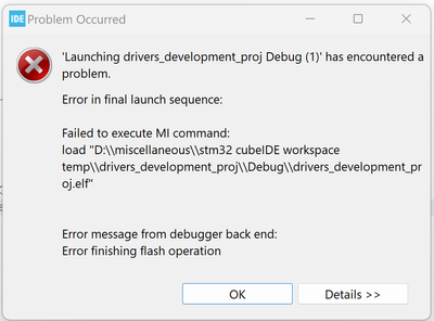

oh, almost forget, after the end of debug session, if I tried to open a new debug session or burn the code, here is what I got:

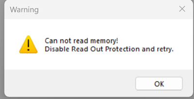

and if I tried to connect to the board using the ST-Link utility, here is what I got:
so in order to return back to RDP = level 0, I click on Target->option bytes->select Level 0 and then Apply.
