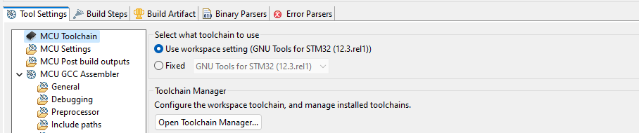

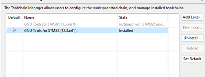

Pavel A.
Jan 13, 2024 19:34 UTC
Well, both internal and external builders fail with  same error, so this is objective. Check in the project (or workspace) properties which  toolchain is used. Is an old toolchain selected, which is no longer installed? If so, install this older toolchain (preferred) or try to jump ahead and choose a toolchain that is available.
Try to reinstall CubeIDE (again, the same version that you've used then, is preferred).

Pavel A.
Jan 14, 2024 15:51 UTC
Can you post a screenshot of the toolchain selection in your project?

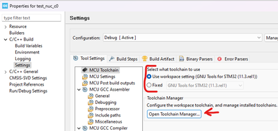

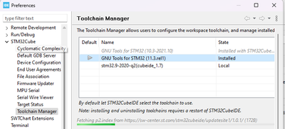

Semer CHERNI
Jan 15, 2024 10:09 UTC
Hello @aelgammal
Could you try to make the build using the "GNU Tools for STM32(11.3.rev1) toolchain.
KR,
Semer.
