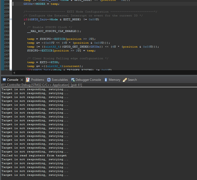

I connect my STM -> I start Debug -> it builds, loads, verifies -> It stopts at HAL_Init() function as always -> when i start F8(continue) it gives the following error

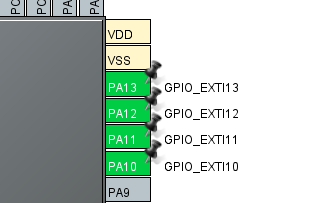

I am getting an error inside the function HAL_GPIO_Init(GPIOA, &GPIO_InitStruct);. I am using 4 PA pins as external interrupt which are ;

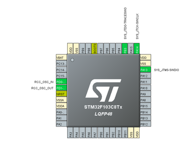

and while the functions loops for initializing the pins one by one, it gives an error at PROBABLY pin PA13 and after seeing that i decided to check the datasheet for stm32f411re and saw this;
i think it is about JTMS-SWDIO function up there in the PA13. And the exact line i get the error is this ;
GPIOx -> MODER =temp;

I removed the pin PA13 from my project and it debugs perfectly well... So I want to know why it creates a problem and why the application does not gives a warning about this i want to know the reason.
There is no error, the cpu doing, what you "ordered" it to do: use pin PA13 as an EXTI , not for debug.
So after debug->flash->starting your program (and no more debug ) is exactly what you defined.
