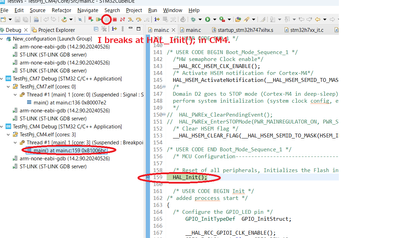

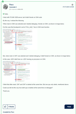

I tried with STLINK GDB server, but it didn't break on CM4 code.
By the way, I noticed the following.
When main in CM4 was selected and I started debuging, it broke on CM4, as shown in image below.
It is the case that breakpoint is set at "HAL_Init();" line in CM4 main function.

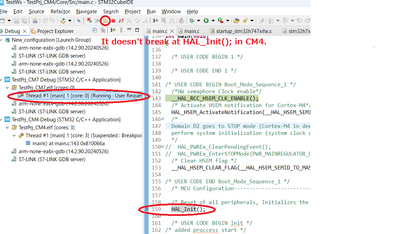

But, when main in CM7 was selected and I started debuging, it didn't break on CM4, as shown in image below.
In this case, LED1 didn't turn on. LED1 turning on proccess is in CM4.
I think that after reset, CM7 and CM7 is started at the same time. But one cpu only starts, mentioned above.
Could you tell me the way how both cpu is started at the same time on debugger?
Thank you.
