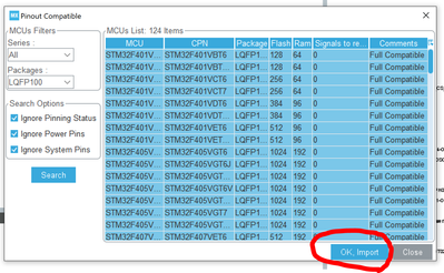

In short, this isn't a supported function and there's not really a straightforward way to do so.
There are some things you can do. Load your IOC in STM32CubeMX and list compatible MCUs (in Pinout menu, or Alt+L) and select one and import. This will change the processor and import your settings, but it won't transfer user code.
You can clone the project and then edit the IOC file directly (along with the .project file), although this is not straightforward.

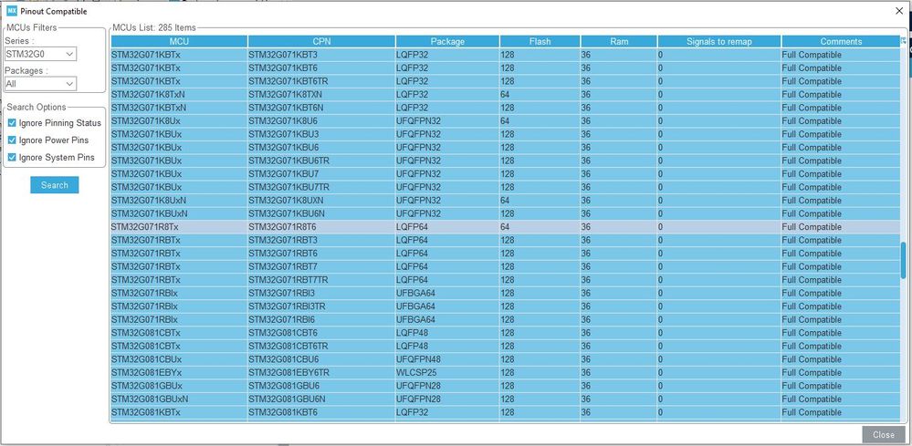

When you mentioned listing compatible MCU's and importing them, I don't see any way to do that. Listing is no problem but selecting the MCU does not bring up any method of importing it(see image below.)
It will show up in the standalone version of STM32CubeMX, but not the one embedded within STM32CubeIDE.

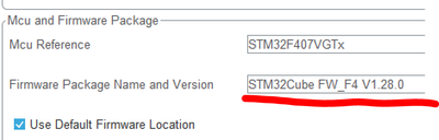

I'm not trying to move off topic but I decided that I would first see how hard it to open a new workspace and bring the code in. The issue I have is that when creating the new project the Device Configuration Tool loaded some of the drivers into the Driver directory. I can't tell which repository STM32CubeIDE v1.12 pulled the code from. My PC has four different repositories under c:\users\username\STM32Cube\Repository and I suspect it is the latest one which is STM32Cube_FW_G0_V1.6.1.
Is there somewhere in STM32CubeIDE or Device Configuration Tool to tell me where it is getting the driver code?
Thanks
It can be found in the Project tab in STM32CubeMX:

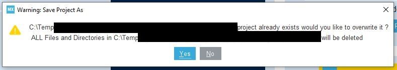

Thanks. I'm going to stick with this method of changing a processor(starting from scratch) as we did try using the standalone STM32CubeMX to modify a working project(created in the IDE) but after saving the modification, the MCU was not changed. It said that was was going to wipe out all the files and directories but they were all still there and the MCU was still the same. I really hope ST makes an easier way to chance the MCU as it is not very straight forward.
