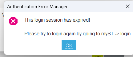

I tried to log in to my ST account in STM32CubeIDE many times but all failed and I received the following message:
I couldn't login to myST account on STM32CubeMX either.
I installed the lastest version of both STM32CubeMX and STM32CubeIDE.

Hello @William838 and welcome to the community,
First try checking the proxy settings by following these steps:
- In Window --> Preferences --> Network Connection, enable Native provider.
- In Window --> Preferences --> Firmware Updater, click on Check Connection
Don't forget to Apply and Close if the connection works.
Then login to "myST" .
Thanks,
