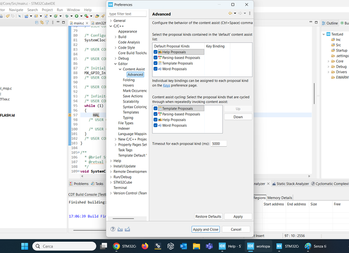

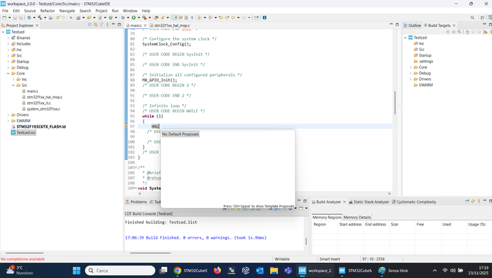

I downloaded stm32cubeIDE 2.0 + stm32cubeMX but I'm having problem in auto complete function in main.c
I tried
https://community.st.com/t5/stm32cubeide-mcus/stm32cubeide-auto-complete-ctrl-space-is-not-working/td-p/342759
but
  • Parsing-based Proposals
are enabled

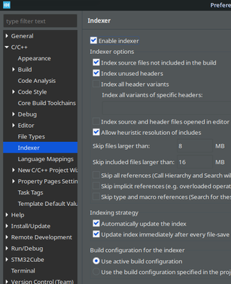

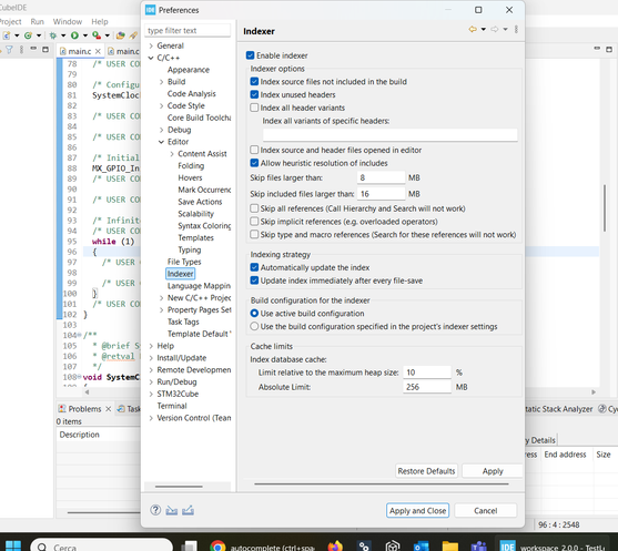

you had it working before ? IDE version ?
indexer enabled ?
Idexer seams to be active.
STM32CubeIDE
Version: 2.0.0
new installation
I generated files with cubeMX and in the same folder open a new project in cubeIDE.

Kram28
I uninstall v 2.0 and install v 1.19 now works fine thanks
