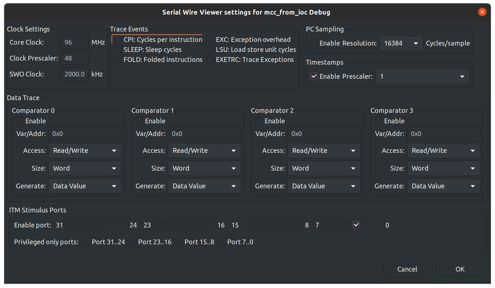

Context:
Here's an example ITM configuration with port 3 enabled:

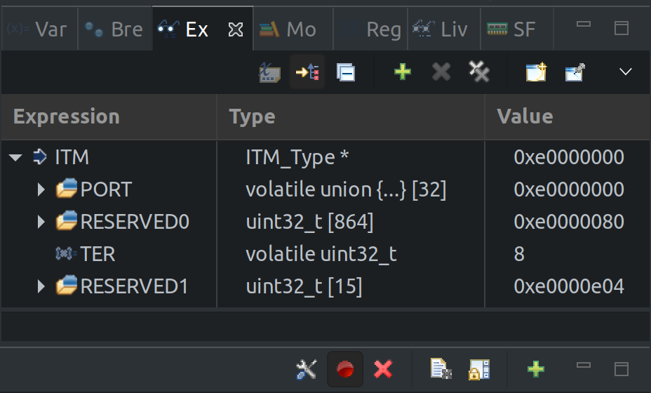

When tracing is enabled in the STM32CubeIDE "SWV ITM Data Console" (click on red circle to "Start Trace"), the bits in the ITM->TER register are set as expected. In this case, value 8 indicates that port 3 is enabled:

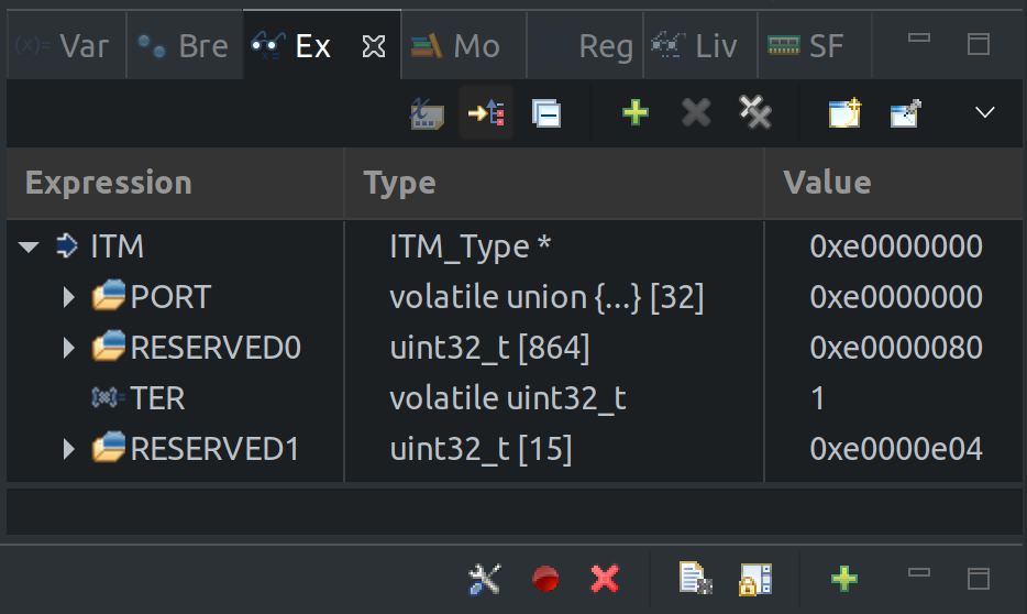

Bug:
But when tracing is disabled, the bits in the ITM->TER register are set to an unexpected (and annoying) default value of 1. This indicates that port 0 is enabled, which is definitely undesired.
This is problematic for common ITM logging code, which checks if the port is enabled before writing to it.
void itmSendBuf(const char *buf, size_t len)
// Check that ITM is enabled and port 0 is enabled
if ((ITM->TCR & ITM_TCR_ITMENA_Msk) && (ITM->TER & (1 << 0)))
for (uint i = 0; i < len; i++)
ITM_SendChar(buf[i]);
The printing loop is always executed, even when the user disables tracing.
A workaround is to configure an additional dummy port (port 2 in this case) to act as a flag for controlling whether to enter the printing loop. That way, when tracing is disabled, at least the dummy port is cleared, so the code can avoid the loop.

‎2020-09-14 4:21 AM
I was able to reproduce when using an F4. It worked as expected when I used an F7.
I'll get back to you after doing some more digging.

‎2020-09-15 2:40 AM
My update is probably not very exciting but:
I don't know why it's happening but I can reproduce it 100% of the time with an F4 so I'll write a ticket.
Thank you for bringing it to my attention!
