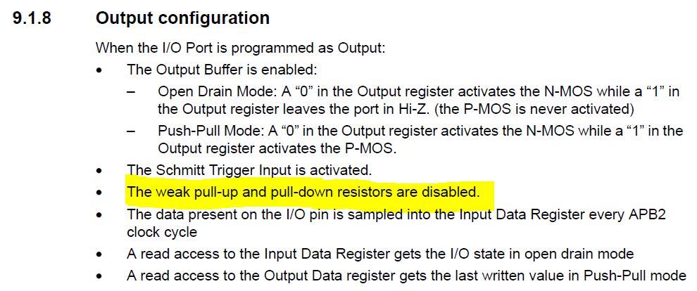

Not really a bug in the LL library, per se.

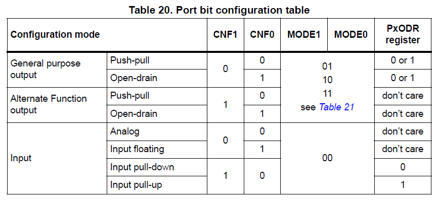

Unlike other families, the STM32F1 family cannot enable a pullup/down in output mode.
When in input mode, the pullup vs pulldown is selected using the ODR register. So it's modifying the right register.
The real issue is that you're calling a function which is cannot be called while in output mode. See the following table for your options:
CubeMX seems to let you set the pullup or pulldown while in output mode, which is a bug. Trying to do so will probably generate the incorrect code you're using.

Hello TDK,
I agree with you and have read the the data sheets, the problem is the (current) implementation in the LL GPIO driver. The 'weak pull up/down resitors are disabled' part is (in my opinion) wrongly implemented in the mentioned driver.
Even if you don't actually set pull up or down it handles as if you set the 'default' (0) value.

Guru
Okay, I agree with what you're saying. The push/pull value is either pullup or pulldown, with no option for no pull. Clearly a bug.
#define IS_LL_GPIO_PULL(__VALUE__)         (((__VALUE__) == LL_GPIO_PULL_DOWN)   ||\
                                            ((__VALUE__) == LL_GPIO_PULL_UP))
If you do choose "No pull", the CubeMX code simply doesn't initialize this parameter, which typically means it'll be 0 and act as if it were set to pulldown (since the whole structure is initialized to zero).
