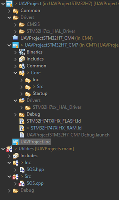

I am working on an STM32 project that utilizes both the CM7 and CM4 cores. I have structured my project to include a static library named Utilities, where I'm facing some challenges with accessing the HAL functionality.
Project Structure:
Utilities
├── .settings
├── Debug
├── Inc
│   └── SOS.hpp
└── Src
    └── SOS.cpp

Here are the compilation errors. I have read "UM2609 Section 2.1.2.2, Creating a new STM32 static library project." My library has no visibility on on those functions or definition for the port or pins. I see how they are used in my dual core executable. But giving my library visibility on them is my problem. Further below I will include screen shots of my C/C++ Build Settings. Maybe I'm missing something there.

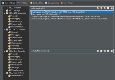

Here is my project structure and include build settings.
I have tried including stm32h7xx_hal_gpio.h and stm32h747xx.h in SOS.cpp to get visibility on those definitions but that generates a ton of new compilation errors that look like this.

Instead of including stm32h7xx_hal_XXX.h or stm32h747xx.h, did you include stm32h7xx_hal.h:
#include "stm32h7xx_hal.h"
@mƎALLEm ,
I'm making progress. I changed my include to stm32h7xx_hal.h and got an error about selecting a target in stm32h7xx.h. There was a Tip in stm32h7xx.h that suggested adding a preprocessor directive to avoid modifying the header file. So I added STM32H747xx to the preprocessor directives:
 Now I am down to a slew of the SAME error (error: '__IO' does not name a type) that occurs for a myriad of stm32*.h header files.

Add also USE_HAL_DRIVER to the preprocessor directives.
Hello @mƎALLEm ,
Adding CORE_CM7 to the preprocessor definitions and making a copy of stm32h7xx_hal_conf.h from the CM7 project and adding it to my library project resulted in a clean compile. Though I don't know if it actually works because I'm having unrelated issues and have not been able to test it yet.
