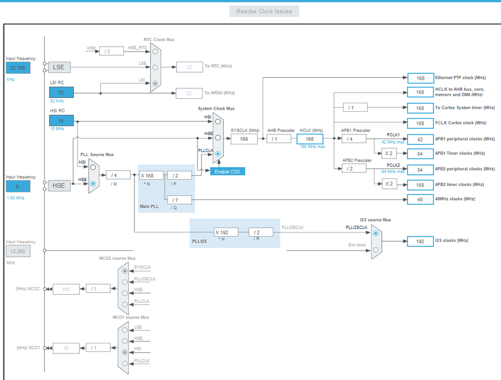

Let's just sort out that the expectations are correct.
If I do this:
- l use CubeMX to generate a project for the STM32F407VG (close enough to the F405).
- Modify the clock tree to get HCLK = 168MHz
- Modify the main() function to look like this:
int main(void)
/* USER CODE BEGIN 1 */
int coreclock = HAL_RCC_GetHCLKFreq(); /* Expected to have 16MHz since no clock tree configuration yet executed */
/* USER CODE END 1 */
HAL_Init();
/* USER CODE BEGIN Init */
/* USER CODE END Init */
SystemClock_Config(); /* Clock tree config done. After this we expecte 168MHz */
/* USER CODE BEGIN SysInit */
coreclock = HAL_RCC_GetHCLKFreq(); /* Will return 168MHz */
int apb1clock = HAL_RCC_GetPCLK1Freq();
int apb2clock = HAL_RCC_GetPCLK2Freq();
/* USER CODE END SysInit */
/* USER CODE BEGIN 2 */
/* USER CODE END 2 */
/* Infinite loop */
/* USER CODE BEGIN WHILE */
while (1)
/* USER CODE END WHILE */
/* USER CODE BEGIN 3 */
/* USER CODE END 3 */
Then the right expectation is that the Core (HCLK) is running at 16MHz until line 17 has been executed.
After line 17, the core will be running at 168MHz.
If I suspend and click reset. Then a system reset is applied. This implies resetting the core and all peripherals (default behavior). So the clock should now go back to 16MHz. The reset button does NOT only set the PC to the first line of Reset_Handler or main.
Now, next question: There is the concept of "restart configurations". This will allow you to modify how a reset/restart is applied during debug. If you or a colleague has tampered with this configuration, then maybe this explains the issue?
Another question: What if you create a new project for this MCU configure the clocks in MCUs like in the real application but keep it minimal. Can you still get the same issue (running slower when debugger connected vs without debugger)? Would be nice to know if the problem is somewhere in your application code or even reproducible in a minimal example.

‎2021-10-22 7:23 AM
The STM32F4 is not a new product series, consequently the STM32CubeF4 is in maintenance mode. No plan (to my knowledge) to add any example projects with ioc-files.
You could try to play with different clock sources to see if you can re-produce the "debug slow-down" only with some clock sources/configurations while not with other. I am afraid that this is a tricky issue to help out with, since we are unable to re-produce...
