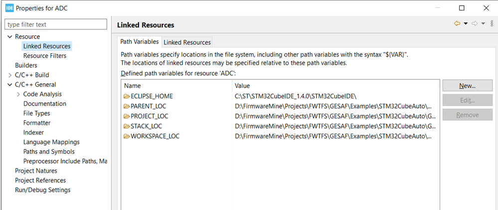

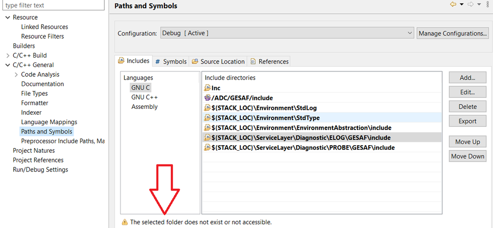

I Added a path variable to the project
and when i'm using this variable with the include files, it can't be recognized
so what is problem?

Unfortunately Path variables cannot be used in CDT settings (Paths and symbols, etc). For this you should define a Build variable (under C++ Build).
At least in this version of Eclipse CDT.
Path variables only work in definition of linked resources.
Yes, very annoying and silly :(
--pa

unbelievable, I'm using this feature with code composer from TI which is based on eclipse from about 7 years ago and this feature was supported.
Thank you very much for your answer!
