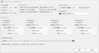

I am developing software using STM32CubeIDE on Windows.
I configured OpenOCD as the DebugProbe in the DebugConfiguration and ran the Debug process
Debug Configuration > STM32 C/C++ Application > BuildName > Debugger
DebugProbe -> ST-LINK (OpenOCD)
Serial Wire Viewer -> Enable: On

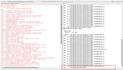

When capturing with SerialWireViewer during debug execution, the program ends unexpectedly, causing the results of the Google tests running within the firmware to be interrupted.
attached file: ConsoleErrorMessage.txt
image_error

SWV ITM Data Console
If you have any idea to do that, that would be very nice to me. Thanks in advance.
My environmental information is as follows:
CubeIDE(Windows11) - ST-Link/v2 - device
STM32CubeIDE:Version: 1.12.1 Build: 16088_20230420_1057 (UTC)
ST-LINK FW: V2J41S7
Device: STM32H7Ax/7Bx

Hello @u1kano ,
After analysing the error message, there is a problem with the connection between your debugger and the target microcontroller.
So, you can try these tips:
- Make sure the debugger is properly connected to the STM32 microcontroller.
- Make sure the target board is properly powered.
- Update the debugger firmware
- Configure the debug settings in STM32CubeIDE correctly by setting the correct device serial number and clock speed for the SWV
Hope this helps!
Thanks,
Rim.
Andrew Neil
August 9, 2024
Does your application put the processor to sleep, and/or reconfigure the debug pins ?

The Google Test running within the firmware has over 200 test cases. Is it possible that the issue might be caused by insufficient SWV buffer?
The debugger and the STM32 microcontroller are properly connected and securely attached.
Power is supplied to the target.
The debugger firmware is up to date.
I have not performed such settings and operations.
