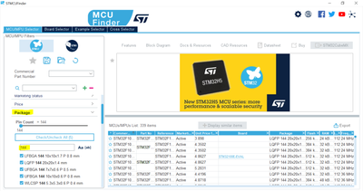

What are the 144 pin MCU s available
KDJEM.1
Hello @SayuraNemi and welcome to the Community :),
The 144 pins package isn't available for STM32F105 Devices. For more information about package, I advise you to refer to the datasheet and precisely 7 Part numbering Section.
You can find all 144 pins devices using ST-MCU-FINDER-PC  or STM32CubeMx tools and filtering products by 144 pins package availability as shown in the below figure
