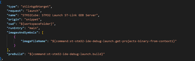

Could you share your debug configuration in launch.json?

            "type": "stlinkgdbtarget",
            "request": "launch",
            "name": "STM32Cube: STM32 Launch ST-Link GDB Server",
            "origin": "snippet",
            "cwd": "${workspaceFolder}",
            "runEntry": "main",
            "imagesAndSymbols": [
                    "imageFileName": "${command:st-stm32-ide-debug-launch.get-projects-binary-from-context1}"
            "preBuild": "${command:st-stm32-ide-debug-launch.build}"
