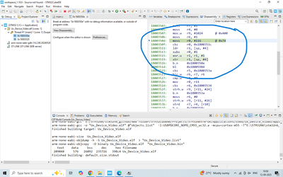

  • I right-click on the Ux_Device_Video→ Debug As → it flashes successfully, but the program never reaches  main(). (Normally in every program the debugger points to first line in main).
  • When I press Run, the debugger only executes a few assembly lines like below and stays there:

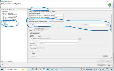

What I observed in Debug Configurations (screenshot attached):
  • For all other example projects, the Debugger tab looks normal , and in this project even FSBL  flashing good and stops at main and behaves as expected.
  • But for Ux_Device_Video, I see an additional “Load Mode” section (highlighted in my screenshot). Other projects don’t have this.
  • Also, under STM32 C/C++ Application, I normally see two entries (e.g. FSBL and the application). But here I only see FSBL, not Ux_Device_Video.
  • The top “Name” field in Debug Config is also empty, unlike other projects.
  • I tried to modify the debug configuration manually to match working examples, but this project does not accept the changes.

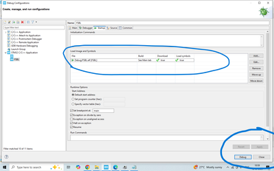

bellow image is FSBL project configuration , i tried to add the same for the ux_device_video  but there is no options( Apply or debug ) are enabled for  change .

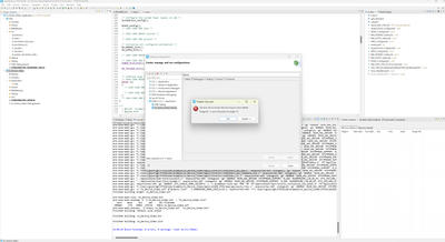

Hello @saib
Have you experienced an error popup similar to this?
THX
Ghofrane
Hello @Ghofrane GSOURI
Yes , Exactly same error , i have observed.
Hello @saib
Thank you very much for your contribution.
The issue has already been reported to the development team under internal ticket 215099 and will be addressed as soon as possible.
