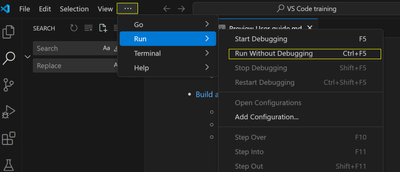

Hello @Sarra.S and thank you for your answer
I tried it and it kind of works, but not in the way I expected. When I click "Run Without Debugging" as you suggested, the debug buttons (those in the image below) still appear and the code does not execute until I click on the red square (which is the stop button, a little counterintuitive). What I expect is that when I click on "Run without debugging" the code will be flashed directly on the MCU, the debug buttons don't show up and the code does not wait for me to click any button at all.

Hello @DamianoF
For the moment, in order to execute this from the VS Code top menu,
  1. Stop the current MCU from running using Shift + F5 (if it is running)
  2. After compiling and flashing with "Run Without Debugging, manually reset the device on the hardware in order to start executing.
Please check Mattias's answer in this thread: New STM32 VSCode extension V2.0.0 released - STMicroelectronics Community

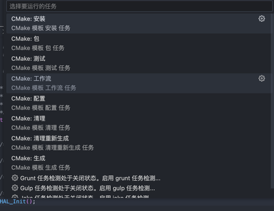

In the tasks.json file, there is a a "task" labeled STM32: CubeProg: Flash project (SWD)
You can execute this task to perform a "flash and reset" altogether!
There are 3 options to execute this:
Option1: By "clicking": Terminal > Run Task... > CubeProg: Flash Project (SWD)
Option2 via Run Task keyboard shortcut:
Option3: Pre-installed keyboard shortcut:
  • CTRL + P
  • Type: "Task CubePro..." <-- You will notice that the menu auto-suggests tasks matching your pattern.
  • CTRL+ALT+F <-- This will immediately execute the same task
You can also make it the default build task by clicking the "Configure Default Build Task" option in the "Terminal" tab. A list of tasks is displayed, select the "CubeProg Flah.." command. Then you can build your project using CTRL + SHIFT + B (which performs the "Run Build Task")
There is no such option. Do I need to download any plugins?
