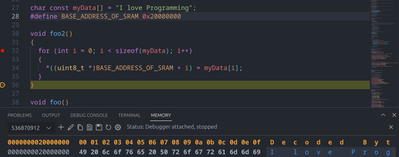

With VS Code I want to use the memory view which works fine for decimal.
But does not seem to work if I have 0x20000000.

Works for me if I enter 0x20000000 after pressing the + (Add new memory view).
Default stm32-for-vscode generated launch file used:

I can even enter &_sdata and see the RAM (depending on your .ld file).
Check your Debug Console tab for suspicious output.
hth
KnarfB
It is strange and probably cortex-debug than stm32. On linux so may try them. Think I can manage with converting to decimal online
