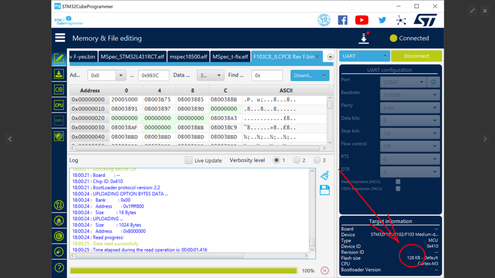

Case 1: With blank MCU, Bootloader via USART1 can only be activated ONCE after power up. (Boot0 pin was soldered to Vcc for testing.) It will never be able to enter BL again after disconnect until power cycled. Error message from programmer:
Case 2: If firmware is downloaded first (via SWD), BL will be able to launch with either power on or reset manually after power on. But some time still fail by manual reset. (about 50%) Here is the screen once it is lauched:
Any idea everyone??? I am in screwed.

Hi, just to comment on something I noticed. In the first message appears the size of 128kB of Flash, the F103C8 model has only 64kB. I already bought BluePill with F103CB (letter B instead of number 8). The F103CB is 128kB of Flash. I believe that there is not much difference in functioning, but it might be interesting to check the specific documents, including Errata if there are any.
https://www.st.com/en/microcontrollers-microprocessors/stm32f103cb.html
https://www.st.com/en/microcontrollers-microprocessors/stm32f103c8.html

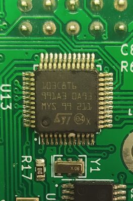

You are right! It supposes to be 64k for F103C8. So is it a counterfeit ? Can you tell by the pic:
I really can't say if it's original, it's better to ask ST :grinning_face_with_sweat:
STOne-32
That marking seems 99% not original and I never seen no proper finish with our laser marking. Or also device original but defective from F103CB part and then re-conditioned and soldered .   The only way to know is to return it to ST or thru your distribution channel .
Thanks for your info. I will ask JLC for details.
