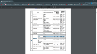

Well the F1 is a very OLD design, it will boot into whatever memory you've selected via BOOT0 / BOOT1 pins, going to get nowhere if FLASH is selected and BLANK. MCU will just crash.
Most reasonable designs provide for a means of getting BOOTx pins into a state which the ROM based System Loader runs, if you need that. Or you use SWD/JTAG, or you implement your own loader, and you don't erase that, just application code deeper into FLASH.
The System Loader is a one-shot deal, it sees whatever noise is on the prescribed pins as being a connection attempt. So a modem or GPS/GNSS that squawks at startup will be seen as the boot source. If the connection fails, reset and try over.
AN2606 should indicate the pins and methods a specific device might expect.
For USB, have a crystal that starts properly / promptly, and use a button so the System Loader boots allowing for USB/DFU connectivity.

STM32F103 ( Medium , Low and High density) are first STM32 from the F1 series put in production and are still running on high volume even now. Initially we do not provide a signature in the system memory to identify the Bootloader version that was added starting from STM32F1 Value line and then on all series.  I confirm that the product contain the bootloader thru UART protocol ( version 2.2).   I Have two options proposal for such issue :
