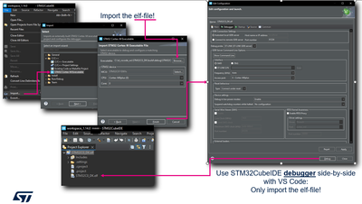

One way of squeezing out maximum "developer efficiency" given the current state of the free ST IDEs is to combine VS Code and STM32CubeIDE:
  • Use VS Code to edit and compile your project and for simple / quick debug sessions
  • Use CubeIDE as a compliment for advanced debug only
This dual-usage is fully possible by:
  1. Starting your CMake project from STM32CubeMX or from VS Code (empty project).
  2. Import and work with the project inside VS Code. All editing and compilation done inside VS Code (or CLI)
  3. Then use the elf-importer inside STM32CubeIDE to benefit from the advance debug features only (not for edit/compile)
Step#3 is accomplished by this wizard in STM32CubeIDE:
Full source code look-up, c-line / assembly instruction stepping and hyper-linking to symbols/code will work despite that the actual c-code is not imported in the CubeIDE project.

Is there a way to still have  CUBEIDE .ioc files for configuration in addition to cmake?If not...
I actually genuinely enjoyed .ioc files and the GUI on the CUBEIDE. I wish i was still able to still use the .ioc files to configure hardware and middleware and have the cmake available for engineers who don't want to actually write code on the IDE. I think it was a bad choice to break the CUBEIDE support to for v2 of the extension.
Also in the extension description it mentions that you can still use this extension with CUEBIDE projects but with some extra manual configuration but I am unable to find how to set that up.
I really think there need to be a standard way to convert CUBEIDE projects to cmake that is officially supported by the IDE such that you can build the project with CMAKE and manually flash/debug with CLI tools like openocd and gdb or optionally use the CUBEIDE makefile structure or whatever it uses
Pavel A.
May 25, 2024
Of course you can (and should) keep the .ioc files.
As @mattias norlander wrote here and in earlier threads: CubeIDE can create a lightweight project from existing .elf file for debugging it in the CubeIDE debugger. Actually this project is an "unmanaged" Eclipse CDT project. You can enhance it, add various settings to assist editing, add the build command and so on.
