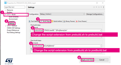

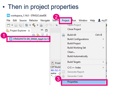

here is a workaround to be able to compile the SMAK application with STM32CubeIDE 1.14.0:
1) copy postbuild.bat from EWARM directory to STM32CubeIDE directory (in SMAK_Appli)
2) Edit the configuration of SMAK project:
in Properties/C/C++ Build/Settings
Tab : Build Steps
Replace .sh by .bat for both Pre-build steps and Post-build steps command
Best regards
Jocelyn
