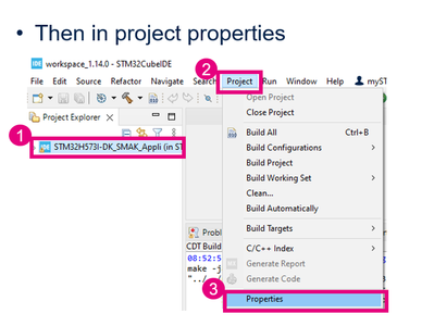

I installed all needed tools and software according to STM32H5_Security_Workshop_tools_installation.pdf but I cannot compile the SMAK application. This is the error message I get:

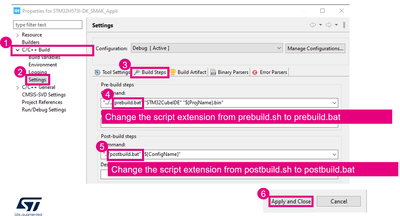

  • Extract the attached postbuild.7z in this folder ( it will replace the current postbuild.bat)
    C:\Users\<your_login>\STM32Cube\Repository\STM32Cube_FW_H5_V1.1.1\Projects\STM32H573I-DK\Applications\ROT\SMAK_Appli\STM32CubeIDE\

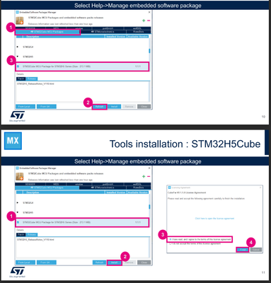

The only thing that might differ is this requirement:
  • STM32Cube_H5_V1.1.0 with STM32Cube_H5_V1.1.1 patch, or later
I installed this according to the instructions in the pdf file provided:
How can the IDE not find the env.sh file even though it's there? is there a path setting that is missing?
