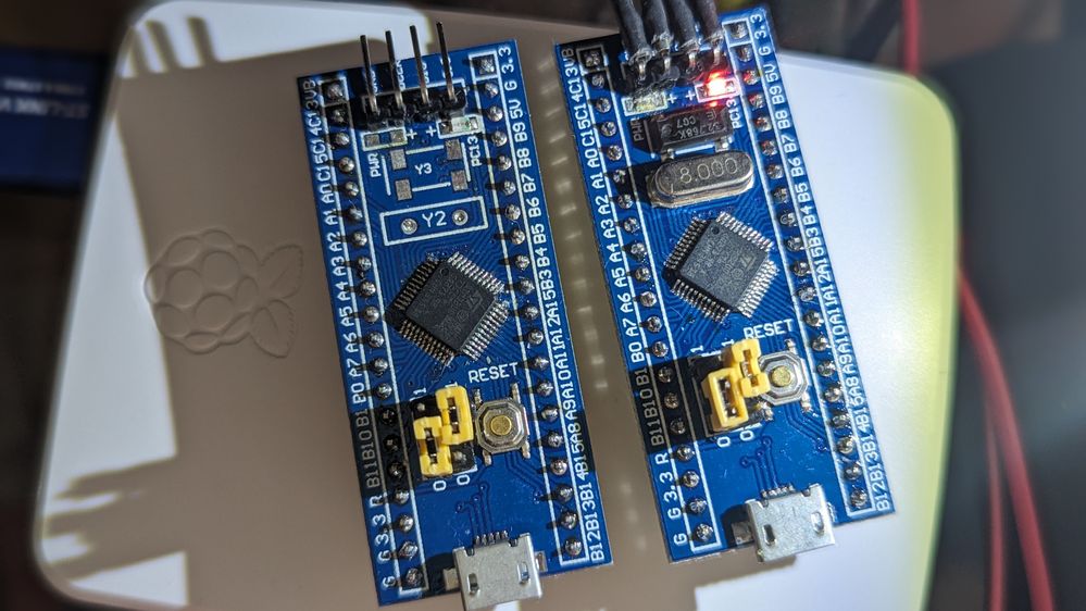

Saw the summit last Tue, 10 stm32u073s arrived Fri from mouser, I had Ada working on it yest (sat). Some work to get the openocd cm0 assembly flash writer to work (l4 version's cm4f code -> cm0+). Ada was the usual porting effort. (I have done F103, L4x3, L476, L151, L5, U585 + others).
Now I do this by hot air rework on $2 bluepill boards. Only U585 ever needed special treatment with a cap from B11 ->GND as per the datasheet.

3) Looking at 0x1fff7000 that seems all 0. I need to figure out a) where the option bytes are and b) why the space reads back a 0. The idea would be a small Ada utility to override these bluepills to use their external (legacy) bootpins in yellow. In that way, you can never brick the part as you can always sram boot and get back in.
For v1.0.0 ST did a nice job on this new part.First 2 U073cc transplants
