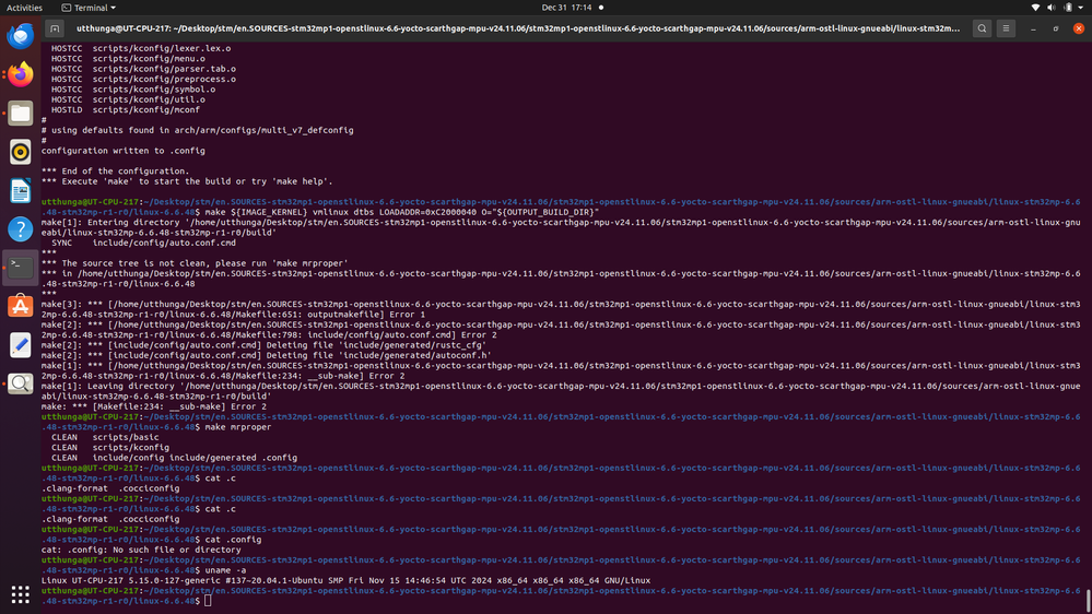

Currently we are facing issue in loading a custom kernel on STM32MP157A).
- To load and build the image for the custom kernel please find the link below which currently we are using
https://wiki.st.com/stm32mpu/wiki/Getting_started/STM32MP1_boards/STM32MP135x-DK/Develop_on_Arm%C2%AE_Cortex%C2%AE-A7/Modify,_rebuild_and_reload_the_Linux%C2%AE_kernel - We have build and install all the dependencies which are required https://www.st.com/en/embedded-software/stm32mp1dev.html here in this we have installed MP1-DEV-SRC .
- The linux system currently we are using is 20.04.1-Ubuntu .

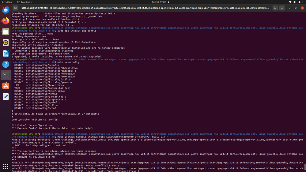

So there is requirement that we need to enable few things from the make menuconfig like RAW GADGET , GADGET FS , GADGET ZERO ,FUNCTION FS. - Eventually when we build the kernel without make menuconfig changes, It builds and runs fine but after any configuration when we run the make ${IMAGE_KERNEL} vmlinux dtbs LOADADDR=0xC2000040 O="${OUTPUT_BUILD_DIR}" command it shows the error in the pic
- Kindly reply a working procedure or any link is appreciated or please tell us what we are doing wrong.

Hi @Jayesh19101999 !
You can modify the kernel configuration after the step...
$ make CROSS_COMPILE=arm-none-eabi- ARCH=arm O="${OUTPUT_BUILD_DIR}" defconfig fragment*.config
...mentioned in the ST Wiki with...
$ make CROSS_COMPILE=arm-none-eabi- ARCH=arm O="${OUTPUT_BUILD_DIR}" menuconfig
...followed by the other steps in the ST Wiki...
$ for f in `ls -1 ../fragment*.config`; do scripts/kconfig/merge_config.sh -m -r -O ${OUTPUT_BUILD_DIR} ${OUTPUT_BUILD_DIR}/.config $f; done
$ (yes '' || true) | make ARCH=arm CROSS_COMPILE=arm-none-eabi- oldconfig O="${OUTPUT_BUILD_DIR}"
This worked for me. Hope it helps.
(The environment variables ARCH=arm and CROSS_COMPILE=arm-none-eabi- where required on my build system on Debian 12, because I don't use the ST toolchains.)
