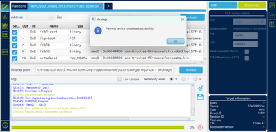

  4. run in cmd: C:\Program Files(x86)\STMicroelectronics\STM32Cube\STM32CubeProgrammer\bin>STM32_Programmer_CLI.exe -c port=usb1 -w C:\<path>\FlashLayout_sdcard_stm32mp157f-dk2-optee.tsv
  5. see result Download.png (as I never saw a correct log I think here something went wrong after "Reconnecting the device ...")

HI PatrickF,
Good news, I found a way to download.
  • I run again start "STM32 USB DFU DRIVER" pnputil -i -a %0\..\Driver\STM32Bootloader.inf but without connected USB and I got a message success (but not sure was this step actual needed).
  • Open CubeProgrammer.
  • So first attempt is like I described and crashes the programmer The usb state is Product ID : DFU in HS Mode @Device ID /0x500, @Revision ID /0x0000.
  • Than without resetting the board I reopen the programmer connect the board but than it is reported Product ID : USB download gadget@Device ID /0x500, @Revision ID /0x2001, @Name /STM32MP157FAC Rev.Z so I thought it will work, but crashes again.
  • Luckily the 3 attempt works until the end and downloads ALL (important dont reset the board leave the state from 2nd attempt)
Attached the uart log with all 3 attempts.
This issue is resolved!!!!
Regards & thx for support,
anpa

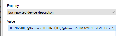

ok, so maybe a missing USB driver on the PC (I guess during CubeProg install).
Could you look at Windows Device Manager (after the 'reconnect') to see if 'reconnected' DFU is present.like this

Hi PatricF,
I tried to reinstall all again but no luck.
I debugged the STM32Bootloader.bat and from if else it enters the:
but the log I get:
pnputil -i -a "c:\Program Files (x86)\STMicroelectronics\STM32Cube\STM32CubeProgrammer\Drivers\DFU_Driver\Driver\STM32Bootloader.inf"
Microsoft PnP Utility
Processing inf : STM32Bootloader.inf
Failed to install the driver : No more data is available.
Total attempted: 1
Number successfully imported: 0
regards
Hi @anpa
strange as CubeProgramer should have been installed in C:\Program Files and not c:\Program Files (x86)
What result did you get if you right click on STM32Bootloader.inf file then select install ?
Regards.
