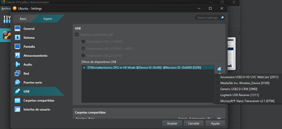

Hi @PatrickF , thanks for the reply.
Indeed, it seems the problem is with the USB. I'm using virtual machine 7.1.2 with Ubuntu 22.04. I can confirm the device is recognized in DFU mode with lusb.
I tried the solution in the other post. Once the process enters into timeout, I jumped into my virtual box configuration and tried to add the "USB download gadget".
The problem is that my virtual box doesn't recognize any "USB download gadget "
The first time I had to add the "DFU in HS mode" inside my virtual box configuration because it wasn't added automatically, but this one doesn't even appear.
Any ideas?
