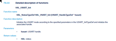

Hello all, good day I hope your Christmas season is going well. I'm looking for a pdf document equivalent of the PDF that is attached to this post that gives description for STM32MP157F-DK2 HAL and low-layer drivers or a HAL API Manual/Programming manual to program our STM32MP157F-DK2 board using STM32CubeIDE. I tried searching the internet for anything of the sort but I couldn't find anything for my STM32MP157F-DK2 board please provide kind support as soon as possible thank you best regards.

The HAL user manual is provided in the Cube Firmware package under STM32Cube_FW_MP1_V1.6.0\Drivers\STM32MP1xx_HAL_Driver\STM32MP157Cxx_CM4_User_Manual.chm
Let us know if it fit your expectation.

Dear Sir/Madam, Good day thank you for your kind reply. Is this the equivalent/something similar of the PDF attached to this reply? Can we use this as an alternative for this PDF for our board?

Hi @purushotham2608 ,
This is not equivalent since the .chm is an automatic generated documentation from code. It does contain not "human" made educational section as you can have in the .pdf.
Anyway, it document the same way all API functions :
eg USART_Init
.chm
.pdf
Note that most of generic "learning" chapter in the L4 pdf are likely applicable to STM32MP1 M4.
Differences to be cross-checked using .chm and code itself.
This is all we can provide as generic documentation. If you are still stuck finding some information, please be more specific in a dedicated post.
Olivier
