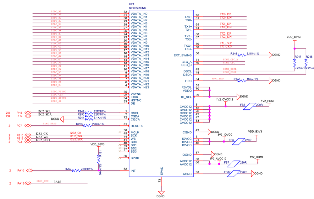

I used the i2c4 for sii9022 chip,but it always busy and don't response for hdmi plug in.

What is the phenomenon of your board now?hdmi no picture?
Direct use of hdmi to connect the display, with hdmi to VGA is not. Test dk1 with hdmi to VGA and display

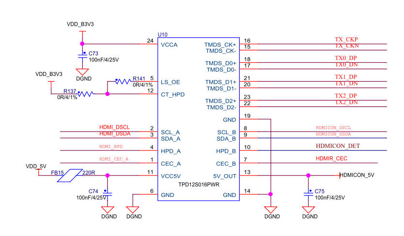

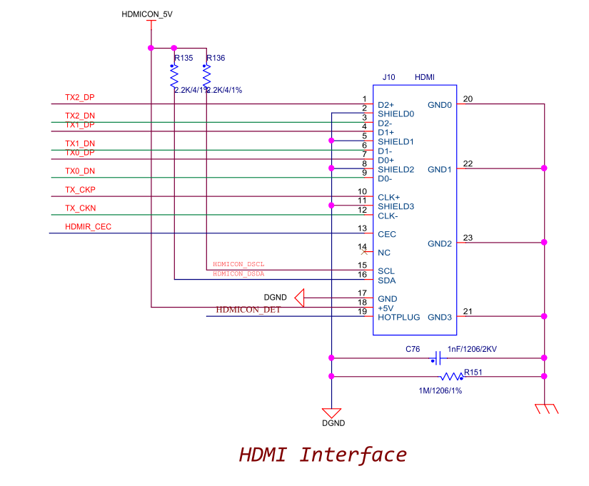

Can you post the hdmi circuit diagram?
It seems that this esd chip has a bug, you can try another hdmi display and try it, the esd I used for the first time also has problems

1.Replace your board hdmi esd.
2.Replace your hdmi display or cable.:)
