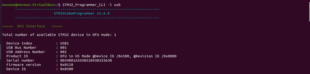

‎2020-11-25 12:12 AM
Works for me.
How did you enter DFU mode? What is the boot pins setting? You can hook-up a terminal prog via ST-LINK serial port and some boot log info from inside.
‎2020-11-25 12:31 AM
Hi KnarfB(Community Member)
Thanks for reply.
boot pins are off only.ST- L INK serial port is not showing device ID.
please check below one.
‎2020-11-25 12:55 AM
Please suggest the how to solve this issue.

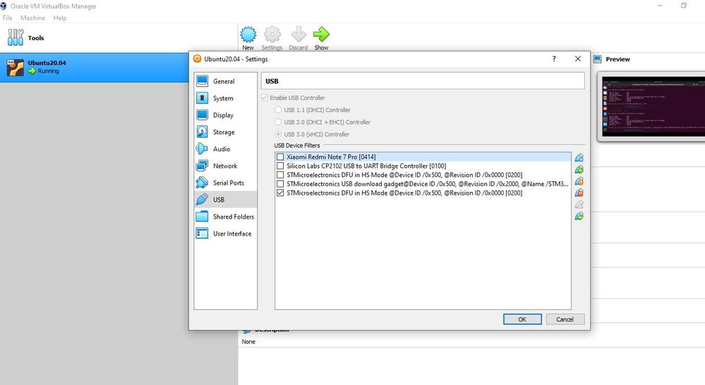

‎2020-11-25 5:29 AM
Hi PatrickF( ST Employee )
when i am given this command dmesg it showing
[26478.877667] usb 1-2: new high-speed USB device number 30 using xhci_hcd
[26479.363719] usb 1-2: New USB device found, idVendor=0483, idProduct=df11, bcdDevice= 2.00
[26479.363723] usb 1-2: New USB device strings: Mfr=1, Product=2, SerialNumber=3
[26479.363726] usb 1-2: Product: USB download gadget@Device ID /0x500, @Revision ID /0x2000, @Name /STM32MP157CAC Rev.B,
[26479.363729] usb 1-2: Manufacturer: STMicroelectronics
[26479.363732] usb 1-2: SerialNumber: 0034001A3438510438333630
[26516.580117] usb 1-2: USB disconnect, device number 30
I am not using USB OTG cable just i am using Typle c cable to my PC.
little bit I understand. Please guide me how to solve this issue.
Thanks.

‎2020-11-25 8:26 AM
your flash download seems ok, so if you reset the board, it should fly.
Best is to look at the console (ST-Link VCP) during boot.
Maybe a too weak supply (1A is barely ok, 2A is the minimum, 3A is recommended)
Could you please followup on https://community.st.com/s/question/0D73W000000VPAS to avoid two parallel discussion thread ?
