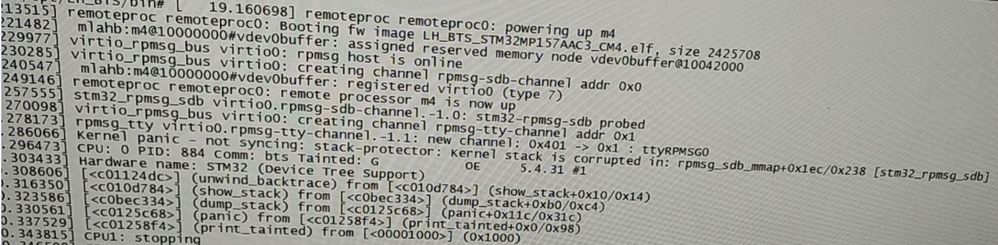

I find the kernel Panic when I mmap 16 shared memory regions.(4KB/memory)

Please check that memory mapping is consistent between kernel dts and MP4 firmware for shared memory.

running into the same issue it looks like there's a simple buffer overflow in the `sprintf` when trying to print an index larger than 9:
https://github.com/STMicroelectronics/meta-st-stm32mpu-app-logicanalyser/pull/3/commits/14b3ddbda9cf7d2413479fb7fbd6aebc0d626a0f
