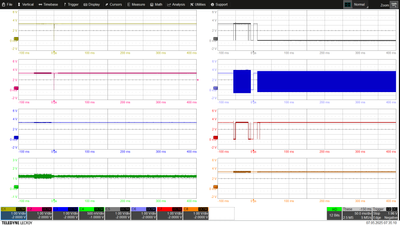

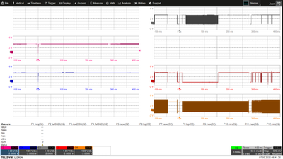

‎2025-05-08 1:00 AM
Hi Oliver,
see attached the logfile.
Rev0200 is with the THGBMNG5D1LBAIL.
Rev0300 is with the SDINBDG4-8G.
In addition, we measured some signals with a scope during reboot:
REV0200 (reboot works)
CH2: NRST // CH3: NRST_CORE // CH5: DAT0 (EMMC) // CH7: CMD (EMMC) // CH8: CLK (EMMC)
REV0300 (reboot isn't working)
CH1: NRST // CH2: NRST_CORE // CH3: PWR_ON (MPU) // CH4: VDDCORE (1.2V) // CH5: CMD (EMMC) // CH6: CLK (EMMC) // CH7: DAT0(EMMC) // CH8: VDD (3.3V)
It looks like the STM just held CMD low because there is a timeout or hanging during Boot-ROM.
Best regards,

‎2025-05-15 11:22 PM
this topic went offline, can be closed.
The main issue fixed with eMMC rst function:
mmc rst-function <dev> <value>
