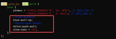

hello,my custom board using stm32mpa35faf7 i2c1, but I forget add externel pull-up resitors.
PD12--->I2C1_SCL
PE8 ---->I2C1_SDA
Now ths i2c seems don't work.

drive-push-pull is wrong for I2C. It is always drive-open-drain
hth

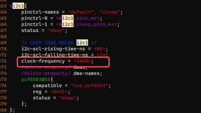

I reconfig the dts tree of i2c1,use inner pull-up and 1K baurate seems not work too
‎2024-06-25 10:08 PM
hth
KnarfB
