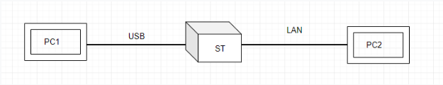

The hardware is STM32MP157C-DK2 board.
1. We setup the test environment as below:
We bridge the USB port and the Ethernet port in the ST.
The throughput is about 270Mbit/sec(Limited by the usb to Ethernet convertor).
2. Another test environment is:
The ST is using the USB gadget functions. The USB port and the Ethernet port are bridged.
Result:
​RNDIS: 90Mbit/sec.
CDC-EEM: 110Mbit/sec.
CDC-ECM: 135Mbit/sec.
The performance is not good enough compared to test1.
Is the speed limited by the USB-OTG controller(dwc2)?
Can we change the DMA settings in the dwc2 ?
Or anyway to improve the throughput?
Please help!
Thank you very much.

The way to improve the throughput is to tune FIFO size in the OTG IP. It can be done through kernel device tree.
In usbotg_hs entry of arch/arm/boot/dts/stm32mp157c.dtsi :
usbotg_hs: usb-otg@49000000 {
	compatible = "st,stm32mp1-hsotg", "snps,dwc2";
	reg = <0x49000000 0x10000>;
	clocks = <&rcc USBO_K>;
	clock-names = "otg";
	resets = <&rcc USBO_R>;
	reset-names = "dwc2";
	interrupts-extended = <&intc GIC_SPI 98 IRQ_TYPE_LEVEL_HIGH>,
			      <&exti 44 1>;
	interrupt-names = "event", "wakeup";
	g-rx-fifo-size = <256>;
	g-np-tx-fifo-size = <32>;
	g-tx-fifo-size = <128 128 64 64 64 64 32 32>;
	dr_mode = "otg";
	usb33d-supply = <&usb33>;
	power-domains = <&pd_core>;
	wakeup-source;
	status = "disabled";
The following patch increases tx troughput (I measured a gain of 12% in TX):
- g-np-tx-fifo-size = <32>;
- g-tx-fifo-size = <128 128 64 64 64 64 32 32>;
+ g-np-tx-fifo-size = <256>;
+ g-tx-fifo-size = <128 128 64 16 16 16 16 16>
The sum of all FIFO size must be lower than 952.
Depending on your use case, you can tune FIFO sizes to get the best compromise.
