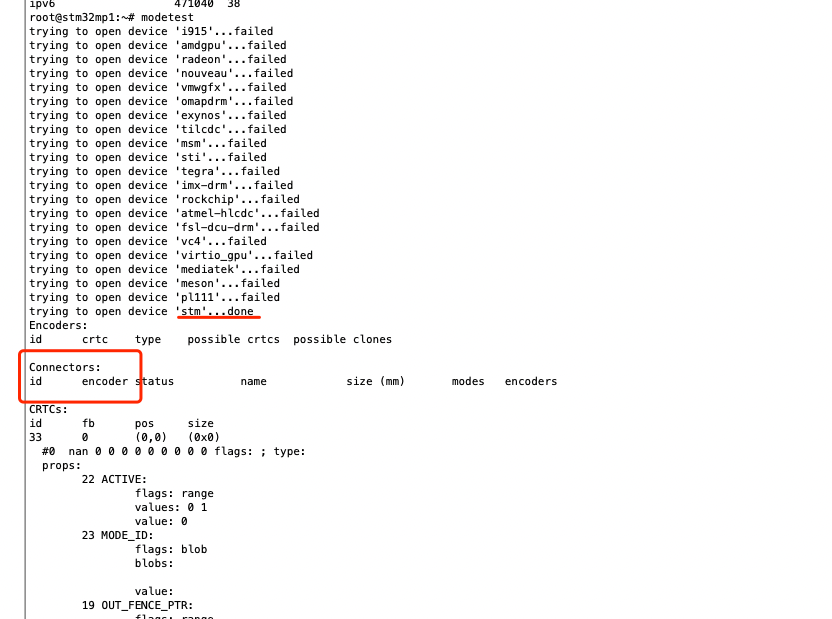

Has anyone been successful using STM MIPI-DSI with 'raspberrypi,7inch-touchscreen-panel' display driver ?
JackyChen

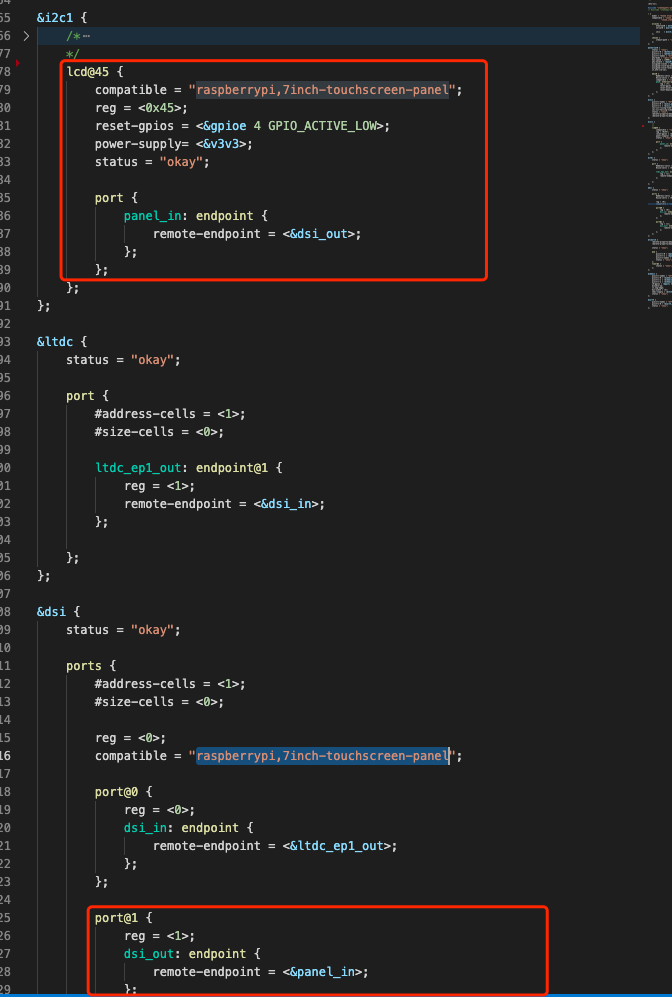

  • 0693W00000D26DMQAZ.png0693W00000D26DCQAZ.pngas the pictures shows,I use stm32mp157c borad to driver the raspberrypi,7inch-touchscree .when the systen run on,i used "modetest" command to list panel on system,I can see panel,but the connector and crtc is null,I can't understander the reason . ask for help

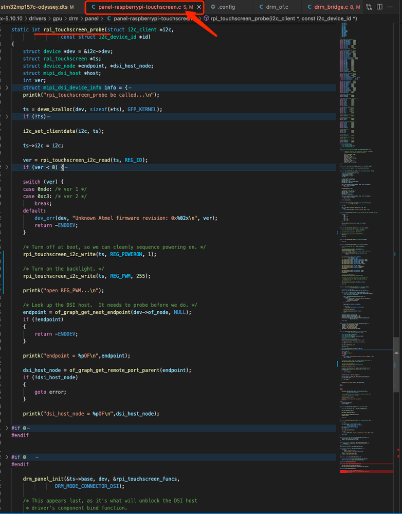

JackyChen
0693W00000D26EjQAJ.pngand this is panel-raspberrypi-touchscreen.c ,the touchscreen driver file
