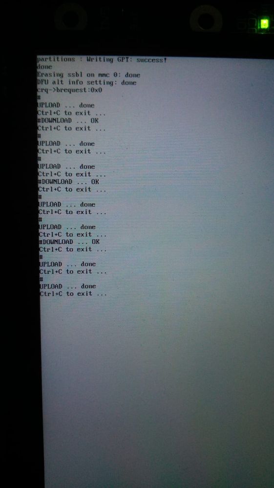

Boot Mode: Forced USB Boot for flashing -> 1,2,3 off / and 4 on
Is this the information of the exact board reference?
I am unsure how to access the UART console log. How can I access it?
I attached an image of the output on the lcd display, and the complete CubeProgrammer log (verbosity level 2).

KMalt.2
Hello @Community member​,
I was not able to try it earlier under Windows, but today I was able to do it.
Now, the image is flashed on the SD card and the board is able to boot and run the GTK Lauchner, like the tutorial.
Thanks alot, so the error was due to complications with my Virtual Machine. Is that common?
Do I have to expect more errors using the CubeIDE with a VM?
Thanks alot
Malte
Hi @KMalt.2​ ,
Thanks for feedback.
No so common, but some instabilities have been reported for USB in some Ubuntu18.04 installation.
Now ST recommend and validate Ubuntu20.04 with VMWare Workstation Player 15 or above.
Worth to try to align with this in order to avoid any environment issue.
Olivier
