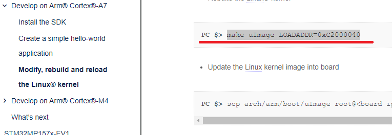

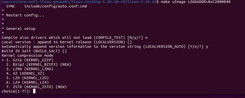

I'm trying to rebuild the kernel as described on the wiki page. When I run make, the wiki shows unexplained choices that eventually result in an error. Is there a possible problem?
0693W00000Bay9iQAB.pngBest Regards
Christophe Guibout
Hi @KNaka.6​ ,
It seems that the kernel configuration is not correct before launching the compilation : did you followed the instructions in Prepare the Linux® kernel source code chapter ?
BR,
Christophe

KNaka.6
After reviewing the my Linux environment, the DistributionPackage was successfully created according to the ST wiki.
Thank you
